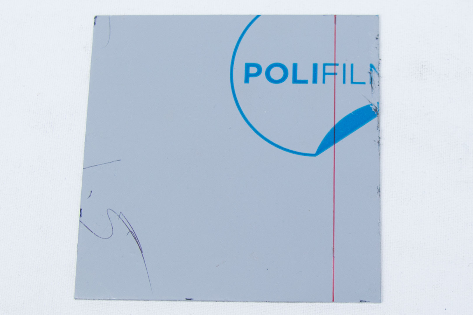

For the mod, you won't need much at all, just a bit of scrap material. In this case, it's some scrap aluminium, but you could use acrylic or steel if you like, anything really. You will also need some screws and some spacers. You can choose whether to use a nut or just tap the threads directly where you want them on the computer case. I chose to tap the thread, so I needed an M3 tap too. You will also need a saw and a drill.

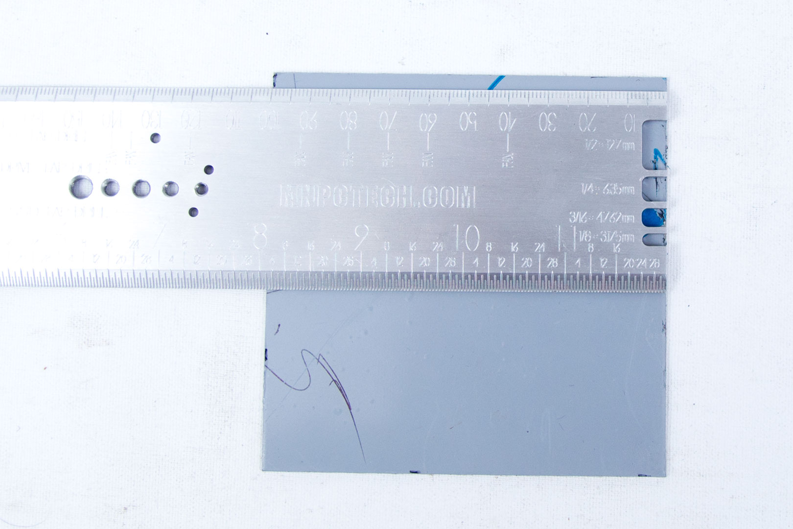

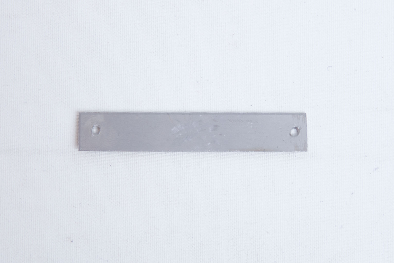

The first step is to measure and mark out how wide you want your brackets. I went for 15mm, as this is just a nice little example to show what I'm doing. You could go as wide or thin as you want; it doesn't really make any difference. A wider bracket would mean being able to personalise the clamp, which I will be doing for the MarzBar build, although I am still working out exactly what design to use there.
Once you've measured everything twice (measure twice, cut once!), it's time to cut it. As per usual, it was raining whilst doing this, so I was limited as to what tools I could use. All my power tools had to stay in the shed, so I was left with a junior hacksaw and a file. It worked just as well as the other I am making, although it doesn't look quite as neat. Once it's cut, drill two holes in: one at either end.
